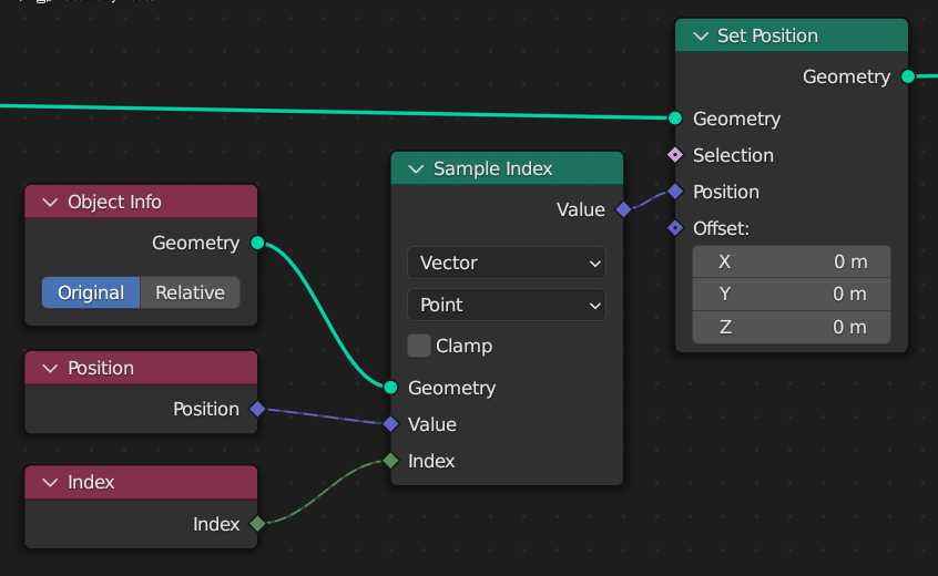

Beispiele
../../../../_images/modeling_geometry-nodes_sample_index-example.png
Here the node is used to copy the positions of one object to another. This recreates the behavior of the Transfer Attribute node from Blender versions before 3.4. This works best when their geometries have the same number of points and the same Topology.
