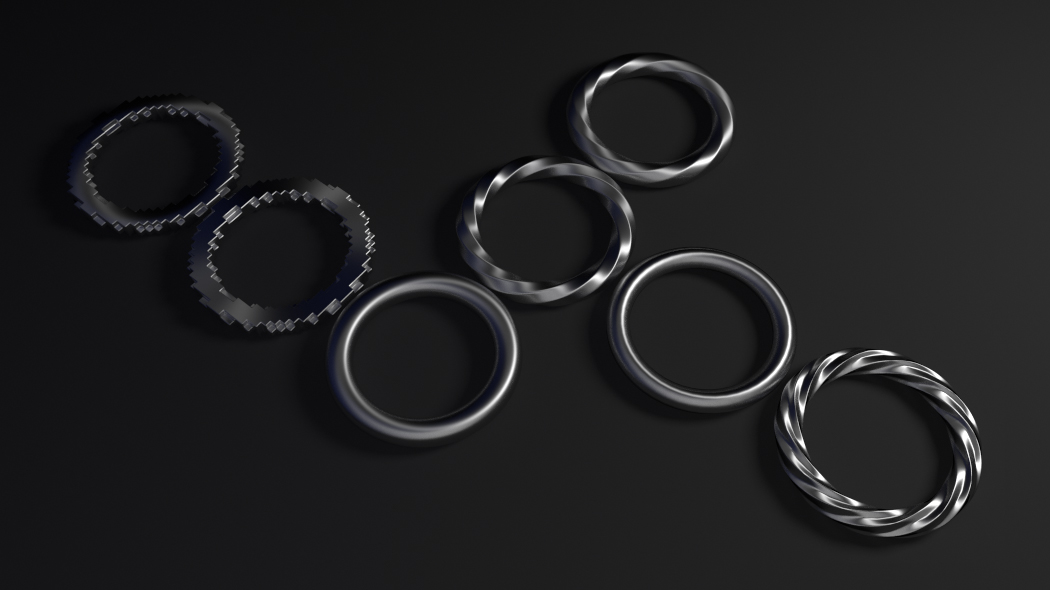

../../../_images/modeling_modifiers_modify_data-transfer_normals-example.jpg
Transferring normals between objects, see example blend-file.
