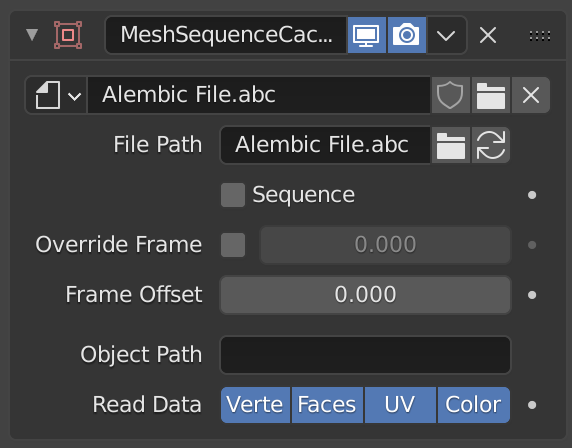

Options
../../../_images/modeling_modifiers_modify_mesh-sequence-cache_panel.png
Cache File
Data-block menu to select the Alembic or USD file.
File Path
Path to Alembic or USD file.
Object Path
The path to the Alembic or USD object inside the archive or stage.
Read Data
Type of data to read for a mesh object, respectively: vertices, polygons, UV maps, and Color Attributes.
Vertices, Faces, UV, Color
Time
Sequence
Whether or not the cache is separated in a series of files.
Override Frame
Whether to use a custom frame for looking up data in the cache file, instead of using the current scene frame.
The Frame value is the time to use for looking up the data in the cache file, or to determine which to use in a file sequence.
Frame Offset
Subtracted from the current frame to use for looking up the data in the cache file, or to determine which file to use in a file sequence.
Velocity
Velocity Attribute
The name of the Alembic attribute used for generating motion blur data; by default, this is .velocities which is standard for most Alembic files.
The Velocity Attribute option is currently for Alembic files only.
Velocity Unit
Defines how the velocity vectors are interpreted with regard to time.
Frame:
The velocity unit was encoded in frames and does not need to be scale by scene FPS.
Second:
The velocity unit was encoded in seconds and needs to be scaled by the scene FPS (1 / FPS).
The Velocity Unit option is currently for Alembic files only.
Velocity Scale
Multiplier used to control the magnitude of the velocity vector for time effects such as motion blur.
The Velocity Scale option is currently for Alembic files only.
