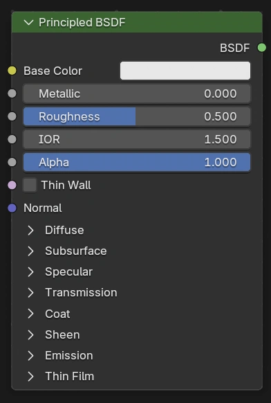

Principled BSDF
Principled BSDF node.
The Principled BSDF that combines multiple layers into a single easy to use node. It can model a wide variety of materials.
It is based on the OpenPBR Surface shading model, and provides parameters compatible with similar PBR shaders found in other software, such as the Disney and Standard Surface models. Image textures painted or baked from software like Substance Painter may be directly linked to the corresponding input in this shader.

Inputs
Base Color
Overall color of the material used for diffuse, subsurface, metal and transmission.
../../../_images/render_shader-nodes_shader_principled-base-color.webp
Same base color for multiple materials types
Roughness
Specifies microfacet roughness of the surface for specular reflection and transmission. A value of 0.0 gives a perfectly sharp reflection, while 1.0 gives a diffuse reflection.
../../../_images/render_shader-nodes_shader_principled-roughness.webp
Roughness from 0.0 to 1.0
Metallic
Blends between a dielectric and metallic material model. At 0.0 the material consists of a diffuse or transmissive base layer, with a specular reflection layer on top. A value of 1.0 gives a fully specular reflection tinted with the base color, without diffuse reflection or transmission.
../../../_images/render_shader-nodes_shader_principled-metallic.webp
Metallic from 0.0 to 1.0
IOR
Index of refraction (IOR) for specular reflection and transmission. For most materials, the IOR is between 1.0 (vacuum and air) and 4.0 (germanium). The default value of 1.5 is a good approximation for glass.
../../../_images/render_shader-nodes_shader_principled-ior.webp
IOR from 1.0 to 2.0
Alpha
Controls the transparency of the surface, with 1.0 fully opaque. Usually linked to the Alpha output of an Image Texture node.
../../../_images/render_shader-nodes_shader_principled-alpha.webp
Alpha from 0.0 to 1.0
Thin Wall
Switch the surface to thin-walled mode. Useful for modeling thin structures, such as papers, leaves, and window sheets.
../../../_images/render_shader-nodes_shader_principled_thin_subsurface.webp
Subsurface Weight = 1, Anisotropy from -0.7 to 0.7
../../../_images/render_shader-nodes_shader_principled_thin_glass.webp
Transmission = 1, Thin Wall off and on
Normal
Controls the normals of the base layers.
