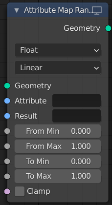

Attribute Map Range
../../../_images/modeling_geometry-nodes_attribute_attribute-map_node.png
The Attribute Map node.
The Map Range node remaps an attribute's value from a range to a target range.

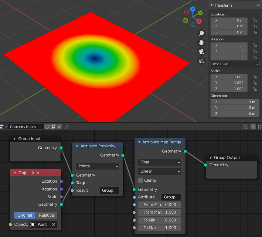

Example
../../../_images/modeling_geometry-nodes_attribute_attribute-map_example.png
Attribute Map node used to adjust a vertex group.
