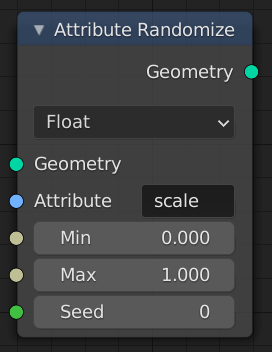

../../../_images/modeling_geometry-nodes_attribute_attribute-randomize_node.png
Attribute Randomize Node.
The Attribute Randomize node replaces the values in an attribute with random values within the given range.

Attribute
Name of the attribute to fill with random values. If there is no attribute with the given name, a new one is created.
Min
The random value will be at least those values.
Max
The random values will be no more than those values.
Seed
Seed to change the random sequence.
