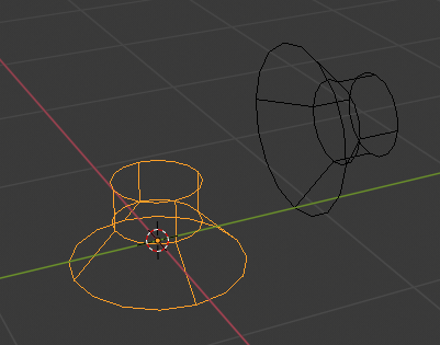

Altoparlante
../../../_images/render_output_audio_speaker_objects.png
Speaker objects.
The speaker object is used to give sound in the 3D Viewport. After adding the object, the various settings can be changed in the Properties.
