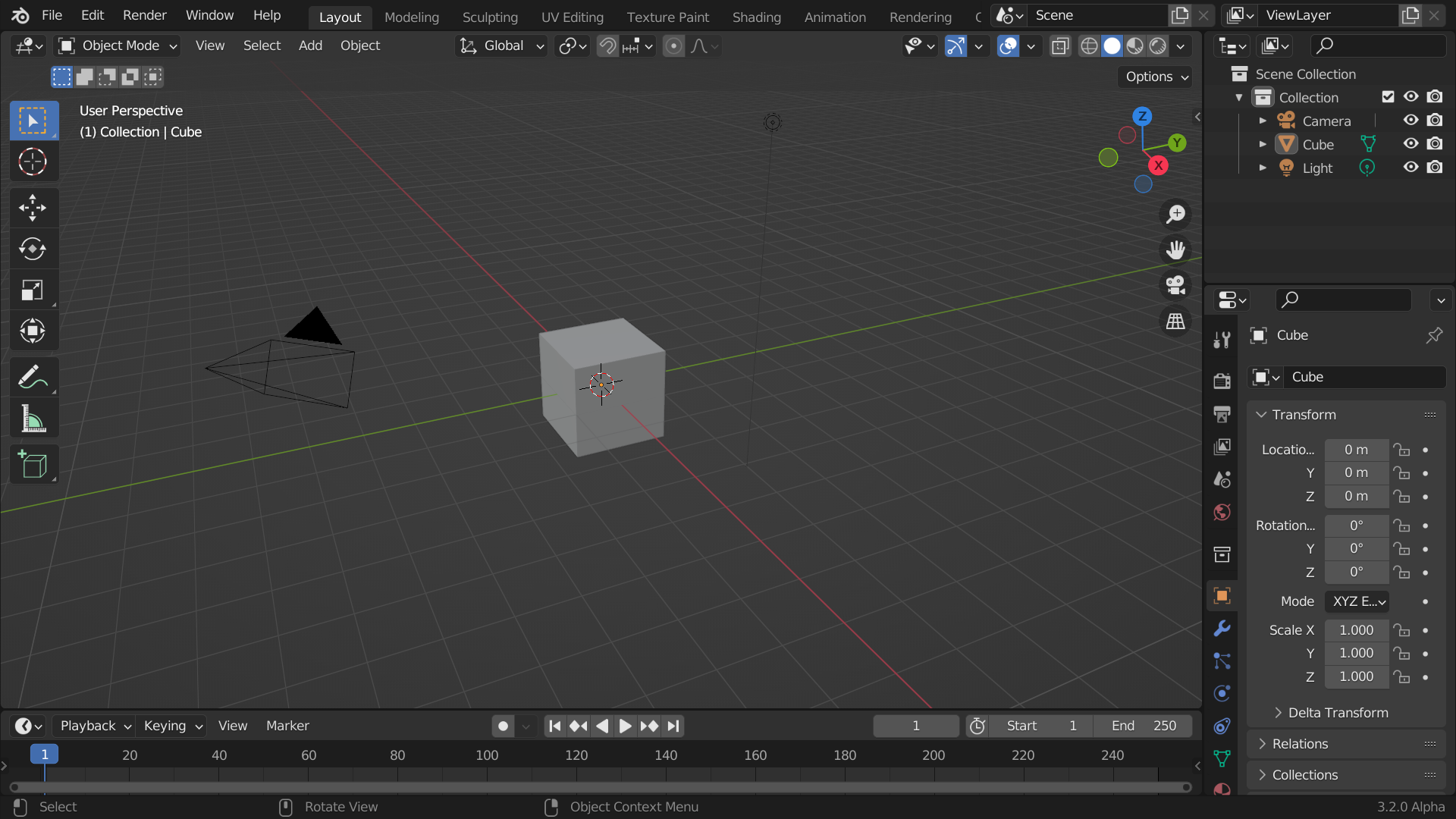

After starting Blender and closing the Splash Screen, the Blender window should look similar to the image below.
La finestra predefinita di Blender all’avvio.¶
L’interfaccia di Blender è divisa in tre parti principali:
The Topbar at the very top, consists of the main menu, which is used for saving, importing and exporting files, configuring settings, and rendering among other functions.
Areas in the middle, which is the main workspace
The Status Bar at the bottom, which displays shortcut suggestions and relevant statistics.
Layout schermo predefinito di Blender. Topbar (blu), Aree (verde) e Barra di stato (rossa).¶
