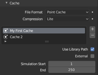

../_images/physics_baking_multi-cache-interface.png
Two different caches stored simultaneously.
Caches List
Blender allows for storing and managing multiple caches at once for the same physics object. You can manage the caches with this list view.
