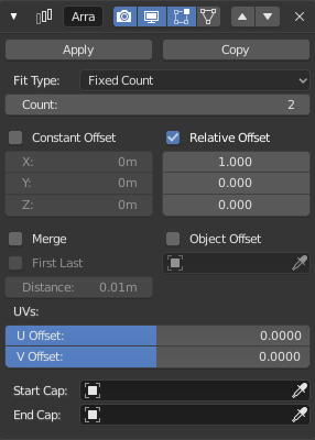

Fit Type
Controls how the length of the array is determined. There are three choices, activating respectively the display of the Curve, Length or Count settings explained below:
Fit Curve
Generates enough copies to fit within the length of the curve object specified in Curve.
Fit Length
Generates enough copies to fit within the fixed length given by Length.
Fixed Count
Generates the number of copies specified in Count.

Offset
Constant Offset, X, Y, Z
Adds a constant translation component to the duplicate object’s offset. X, Y and Z constant components can be specified.
Relative Offset, X, Y, Z
Adds a translation equal to the object’s bounding box size along each axis, multiplied by a scaling factor, to the offset. X, Y and Z scaling factors can be specified.

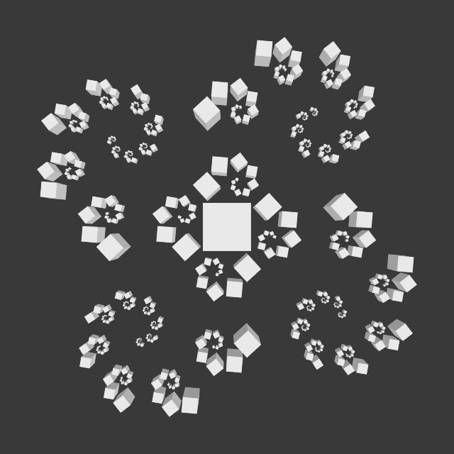

../../../_images/modeling_modifiers_generate_array_example-fractal-1.jpg
Multi-level array animated with motion blur.
../../../_images/modeling_modifiers_generate_array_example-fractal-2.png
Fractal created with multiple arrays. Sample blend-file.
