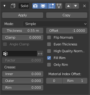

Simple Mode
This is the default solidify algorithm, which simply extrudes the geometry. This algorithm does not work on geometry where edges have more than two adjacent faces.
Crease
These options are intended for usage with the Subdivision Surface modifier.
../../../_images/modeling_modifiers_generate_solidify_rims.png
Edges which will get creases marked.
Inner
Set a crease to the inner edges.
Outer
Set a crease to the outer edges.
Rim
Set a crease to the rim.
Even Thickness
Maintain thickness by adjusting for sharp corners. Sometimes improves quality but also increases computation time.
High Quality Normals
Normals are calculated to produce a more even thickness. Sometimes improves quality but also increases computation time.
중요
If the normals of adjacent faces don’t point into the same general direction, simple mode will not be able to solidify the boundary between those. This happens if the normals are not recalculated or for example on one-sided surfaces like a Möbius strip.
