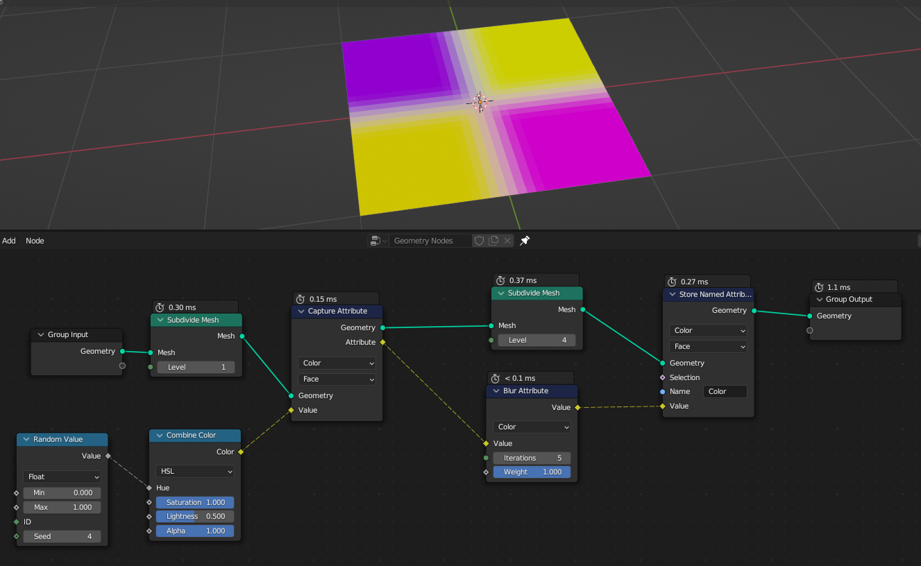

Voorbeelden#
Input is Mesh Plane. First Subdivide Mesh Node add some faces for capture color with Random Value Node used as hue in Combine Color Node on this. Now second Subdivide Mesh Node split each face on a lot of new. Each one new duplicates original attribute. Blur Attribute node mixes all attributes for each face. Due to this, the result is smoothed.
