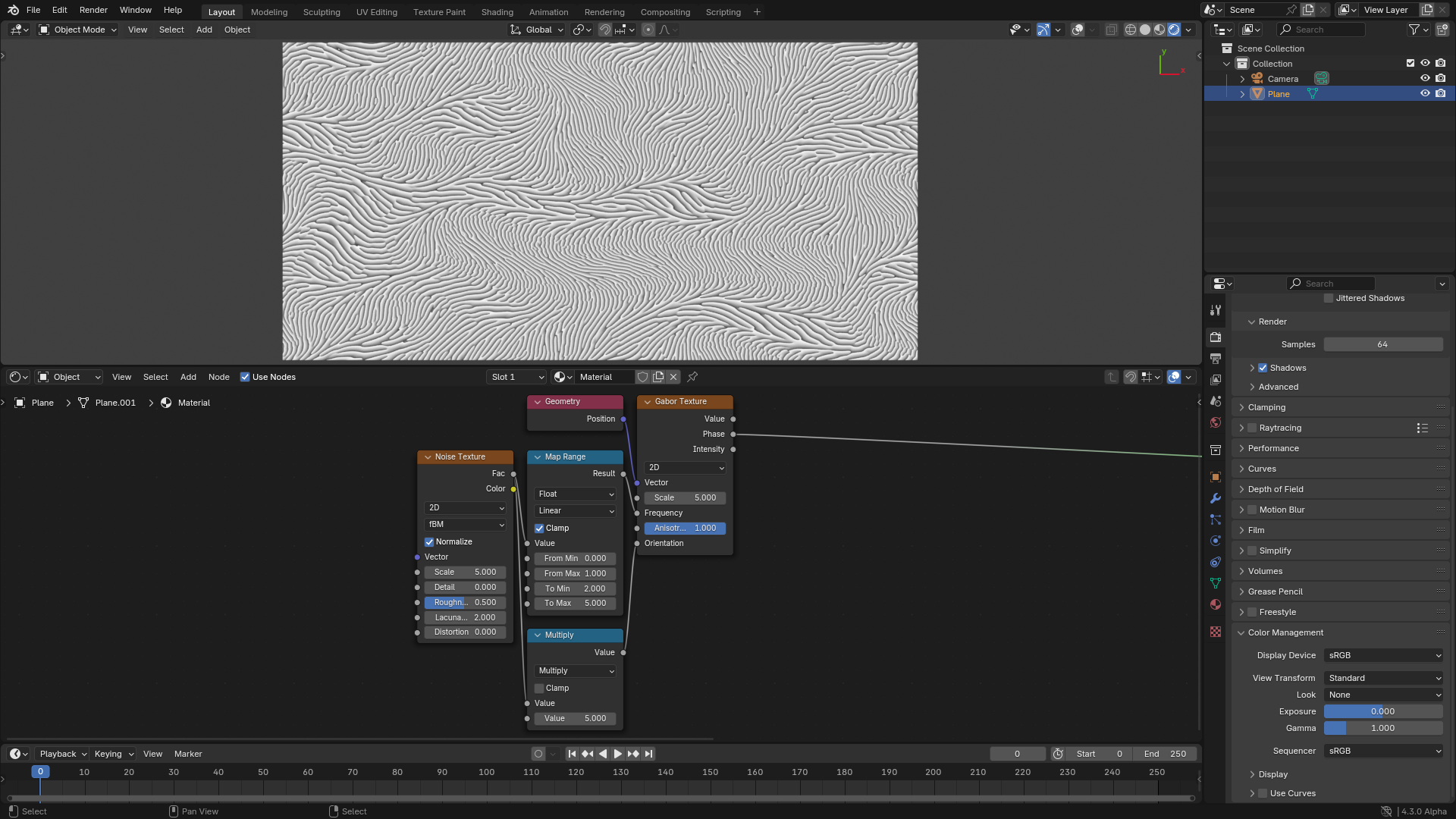

The main advantage and use of the Intensity output is that it provides information about the location of singularities in the Phase output. Singularities are those areas in the phase where the bands meet, which are shown in red in the following figure. Those areas will be close to zero in the Intensity output. So if those areas are undesirable, they can be hidden by multiplying by a variant of the Intensity output.
Visualization of the areas where singularities happen.¶
Inputs can be varies across space to get more interesting patterns.
Varying the frequency and orientation across space.¶
