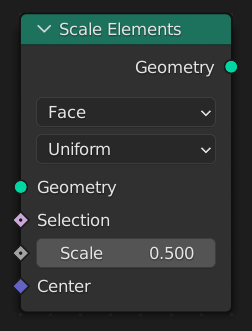

Scale Elements Node
../../../_images/modeling_geometry-nodes_scale-elements_node.png
The Scale Elements node.
The Scale Elements Node scales groups of connected edges and faces. When multiple selected faces/edges share the same vertices, they are scaled together. The center and scaling factor is averaged in this case.
