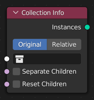

Collection Info Node
O nó Collection Info obtém informações de coleções. Isso pode ser útil para controlar parâmetros na árvore dos nós de geometria com uma coleção externa.
Dica
Um nó Collection Info pode ser adicionado rapidamente arrastando uma coleção no editor de nós.
Inputs
- Collection (coleção)
Coleção para obter as propriedades.
- Separate Children
Output each child of the collection as a separate instance. The list of instances will be sorted alphabetically with the objects and child collections sorted together. This can be used with the Pick Instance option in the Instance on Points Node to choose between collection children at each point.
- Reset Children
Remove the transform of each of the collection’s children when converting them to instances. This is useful in order to keep child objects visually separate in the viewport, while keeping every instance located directly at the location of the point it was added for.
Propriedades
- Transform Space
The transformation of the output instances. The instances are transformed, but not the geometry of the collection in them.
- Original:
Output the instances relative to the collection offset.
- Relative:
Join the input collection instances with the modified object as geometry, maintaining the relative position between the objects in the scene.
Saídas
- Instances
Instances of the collection in world space with all modifiers applied and represented as geometry in instances.
