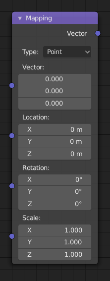

The Mapping node transforms the input vector by applying translation, rotation, and scaling.
Mapping node.
Входы
The inputs of the node are dynamic. In particular, the Location input is only available in the Texture and Point vector types.
- Vector
The vector to be transformed.
- Расположение
The amount of translation along each axis.
- Rotation (вращение)
The amount of rotation along each axis. XYZ order.
- Scale (масштаб)
The amount of scaling along each axis.
