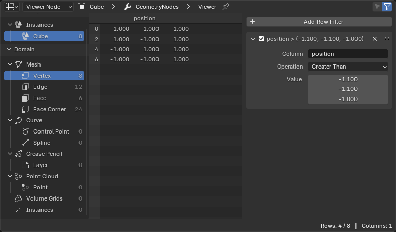

The Spreadsheet editor is used to inspect the geometry attributes of the active object, typically in order to debug geometry nodes.

- Toggle Pin
Click to „lock” the editor to the currently active object, and have it keep displaying that object’s data even if another object becomes active. Click again to unlock.
- Selected Only
This option is only available if the object is in Edit Mode. When checked, only data for the selected geometry elements is shown.
- Use Filter
Whether to use the filters that are defined in the Sidebar (see below).

The main view shows the actual spreadsheet. Column names and row indices remain visible when scrolling down or to the side.

Data Set Region¶
With region on the left, you can choose what to display data for. The top tree lets you pick from the hierarchy of geometries, such as a mesh inside an instance. The bottom tree lets you pick a domain, such as mesh vertices or curve splines.
Each tree item shows the number of elements inside.
Status Bar¶
The status bar shows how many rows and columns there are, and how many rows remain after filtering.
