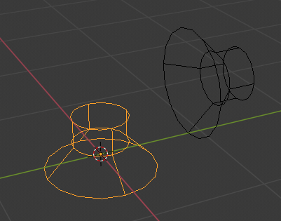

Speaker¶
Speaker objects.¶
The speaker object is used to give sound in the 3D Viewport. After adding the object, the various settings can be changed in the Properties.
