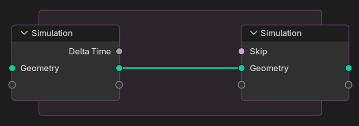

Initial simulation nodes and simulation zone.¶
When adding a simulation, two nodes are added, defining between them a „Simulation Zone”.
The inputs that are connected to the Simulation Input node are evaluated only once, at the beginning of the simulation, passed to the next simulation state and eventually outputted. Other nodes can be linked inside the simulation region from the outside. Those are re-evaluated every step based on their value at the given frame.
It is not possible to have any link going towards outside. The result of the simulation can only be accessed via the Simulation Output node. This also allows sub-frame interpolation for motion blur.

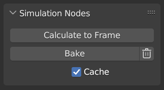

Baking¶
The simulation is automatically cached during playback. The valid cache can be seen as a strong yellow line in the timeline editor. This allows for animators to quickly inspect all the previous frames of a simulation.
Cached frames in the Timeline.¶
For the cases where the current frame is the only one relevant, users can opt-out of „Cache” to save memory.
When the result is ready to be sent to a render-farm, it can be baked to disk. This allows for the simulation to be rendered in a non-sequential order.
Simulation and Physics, Simulation Nodes user interface.¶
Белешка
Baking the simulation will bake all the simulations in all modifiers for the selected objects.
