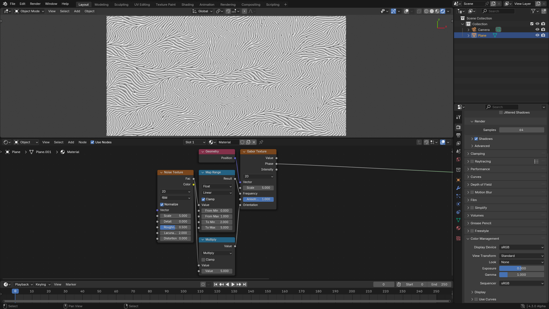

Inputs can be varies across space to get more interesting patterns.
Varying the frequency and orientation across space.¶
