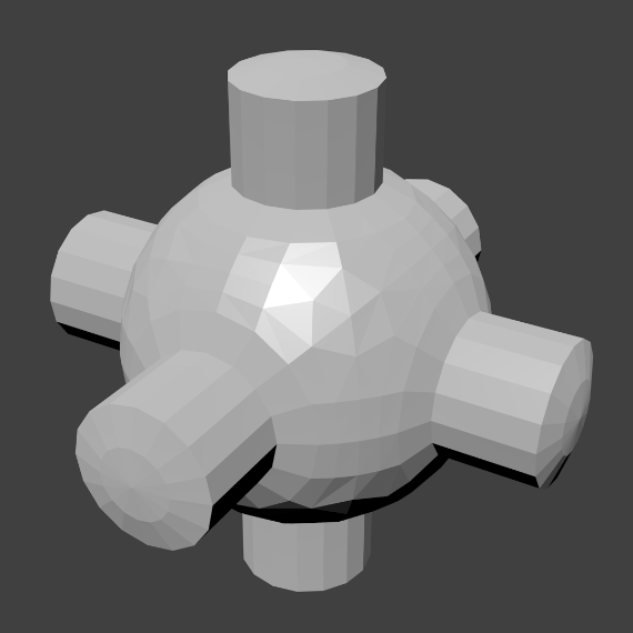

Notice that the outline of the object is still strongly faceted. Activating the smoothing features does not actually modify the object’s geometry; it changes the way the shading is calculated across the surfaces (normals will be interpolated), giving the illusion of a smooth surface.
Using Shade Flat will revert the shading back (normals will be constant) to that shown in the first image below.
Example mesh flat (left) and smooth-shaded (right). Sample blend-file.#
../../../_images/scene-layout_object_editing_shading_example-flat.png
../../../_images/scene-layout_object_editing_shading_example-smooth.png
