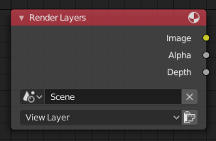

This node is the starting place for getting a picture of your scene into the compositing node tree.
Inputs¶
This node has no input sockets.
Properties¶
- Scene
Select the scene within your blend-file. The scene information taken is the raw footage (pre-compositing and pre-sequencing).
Consejo
To use composited footage from another scene, it has to be rendered into a multi-layer frameset (e.g.
OpenEXR) as an intermediate file store and then imported with Image input node again.- Render layer
A list of available Render Layers. The render button is a short hand to re-render the active scene.
Outputs¶
- Image
Rendered image.
- Alpha
Alpha channel.
Render passes sockets
Depending on the Render passes that are enabled, other sockets are available. See render passes.
- Z
By default the Z depth pass is enabled.
