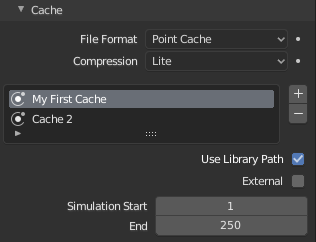

../_images/physics_baking_multi-cache-interface.png
Two different caches stored simultaneously.

Blender allows for storing and managing multiple caches at once for the same physics object. You can manage the caches with this list view. Double-click the cache entry to give it a name.
Tùy Chọn -- Options
Cache Name
Each cache can have a name. If this name is given, any disk cache will be stored in files starting with that name. For example, a cache named 'MyCache' will be stored in MyCache_xxxxxx_yy.bphys.
If the cache does not have a name (which is the default), the filename of the cache will depend on the object it is attached to, although this is not immediately obvious. For example, a cache on an object Cube will be stored in 43756265_xxxxxx_yy.bphys, where 43756265 is determined by the object name.
Cảnh báo
When there are multiple caches on one object, always specify a Cache Name. As described above, the filename of an unnamed cache is determined by the name of the object it is attached to. As a result, an object with multiple physics systems that all have an unnamed cache will cause conflict and can result in losing cache files.
