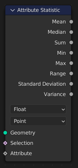

The Attribute Statistic node.
The Attribute Statistic node evaluates a field on a geometry and outputs a statistic about the entire data set.
