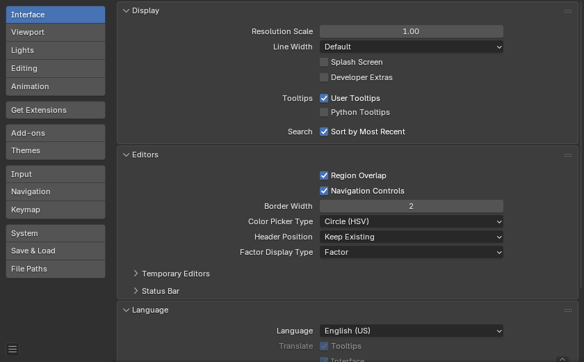

This chapter explains how to change Blender’s default configuration with the Preferences editor.
The Blender Preferences contains settings to control how Blender behaves. At the left of the editor, the available options are grouped into sections.
