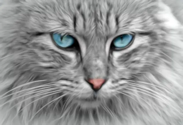

Kuwahara Node¶
The Kuwahara node implements the Kuwahara filter as well as its anisotropic variant. The Kuwahara filter is a smoothing filter that tries to preserve the edges in the image. The smoothing effect of the anisotropic variant is similar to brush strokes, so the node can be used to create stylized painting effects.
