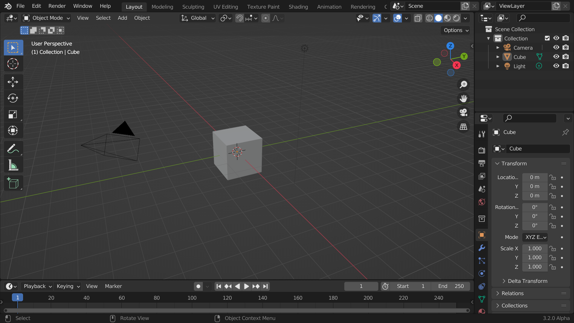

After starting Blender and closing the Splash Screen, the Blender window should look similar to the image below.
블렌더의 초기 상태 화면.#
블렌더의 인터페이스는 3개의 부분으로 나눠져요:
The Topbar at the very top, consists of the main menu, which is used for saving, importing and exporting files, configuring settings, and rendering among other functions.
Areas in the middle, which is the main workspace
The Status Bar at the bottom, which displays shortcut suggestions and relevant statistics.
블렌더 화면의 초기 상태에요. 파란색은 Topbar, 초록색이 Area, 빨간색이 Status bar를 나타내고 있어요.#
