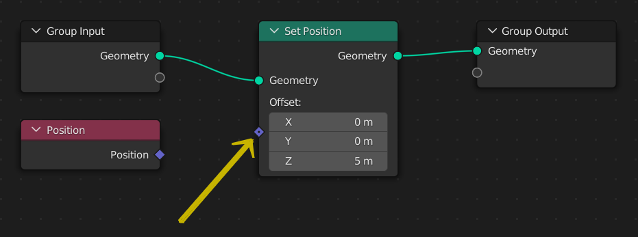

- Diamond with Dot:
The socket can be a field, but it is currently a single value. This is helpful because it allows tracking where single values are calculated, instead of a field with many different results. It also means that Socket Inspection will show the value instead of field input names.
The socket shape is a diamond with a dot, meaning the field has the same value for every element. Every point will be moved up by 5 m.#
