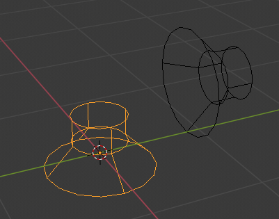

The speaker object is used to give sound in the 3D Viewport. After adding the object, the various settings can be changed in the Properties.

Cone#
Directionality relevant settings.
Imagine a cone with the top at the original of the speaker object and the main axis of it facing in the same direction as the speaker. There are two cones an inner and an outer cone. The angles represent their opening angles, so 360° mean the cone is fully open and there is no directionality anymore. Inside the inner cone the volume is full (1.0), outside the outer cone the volume is, whatever one sets for the outer cone volume and the volume between those two cones, linearly interpolated between this two volumes.
