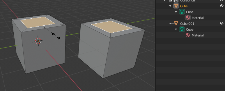

The Cube object was linked duplicated.#
The object Cube was linked duplicated, using Alt-D.
Though both these cubes are separate objects with unique names:
Cube and Cube.001, the single mesh named Cube, is shared by both.
As a mesh is edited in Edit Mode in one object, the same occurs in the other cube as well. The mesh data are links, not copies.
In contrast, if one of these two cubes is rotated or scaled in Object Mode, the other remains unchanged. The transform properties are copied, not linked.
As in the previous example, the newly created cube has inherited the material of the original cube. The material properties are linked, not copied.
