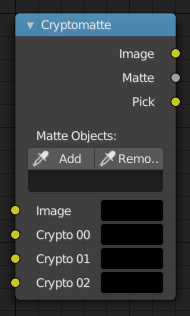

- Crypto Passes
Each crypto layer will be given its own render pass; each of these render passes must be connected to one of these crypto layer inputs. By default there are only four layers, see Adding/Removing Layers to add more.

- Add/Remove
Adds/Removes an object or material from matte, by picking a color from the Pick output.

In the compositing nodes, create a Cryptomatte node and link the Render Layer matching Image and Cryptomatte passes to it.
Attach a Viewer node to the Pick output of the Cryptomatte node.
Use the Cryptomatte Add/Remove button to sample objects in the Pick Viewer node.
Use the Matte output of the Cryptomatte node to get the alpha mask.
