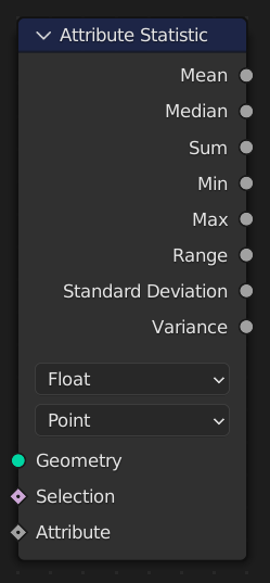

Attribute Statistic Node
../../../_images/modeling_geometry-nodes_attribute_attribute-statistic_node.png
The Attribute Statistic node.
The Attribute Statistic node evaluates a field on a geometry and outputs a statistic about the entire data set.
