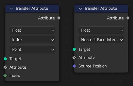

Transfer Attribute node.
The Transfer Attribute node retrieves values from a source geometry and provides them as a field, so they can be used anywhere.
