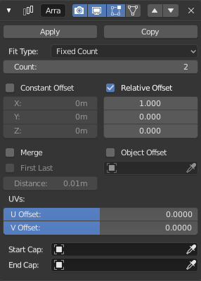

Phương Phát Khít Vừa -- Fit Type
Controls how the length of the array is determined. There are three choices, activating respectively the display of the Curve, Length or Count settings explained below:
Khít Vừa Đường Cong -- Fit Curve
Generates enough copies to fit within the length of the curve object specified in Curve.
Khít Vừa Chiều Dài -- Fit Length
Generates enough copies to fit within the fixed length given by Length.
Số Lượng Cố Định -- Fixed Count
Generates the number of copies specified in Count.

Dịch Chuyển -- Offset
-- Constant Offset, X, Y, Z
Adds a constant translation component to the duplicate object's offset. X, Y and Z constant components can be specified.
-- Relative Offset, X, Y, Z
Adds a translation equal to the object's bounding box size along each axis, multiplied by a scaling factor, to the offset. X, Y and Z scaling factors can be specified.
