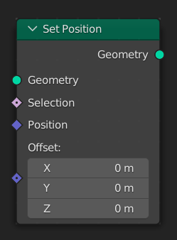

Vị Trí Mặt Trời (Set Position Node)
../../../_images/modeling_geometry-nodes_geometry_set-position_node.png
Trọng Lượng Vị Trí.
The Set Position node controls the location of each point, the same way as controlling the position attribute. If the input geometry contains instances, this node will affect the location of the origin of each instance.
The input node for this data is the Vị Trí -- Position (Position Node).
Đầu Vào (Inputs)
Hình Học (Geometry)
Standard geometry input.
Lựa Chọn (Selection)
Whether or not to change the position of each point or instance. True values mean the position will be changed, false values mean it will remain the same.
Vị Trí (Position)
The new position for selected elements. By default, this is the same as if the Vị Trí -- Position (Position Node) was connected, meaning the node will do nothing.
Dịch Chuyển (Offset)
An optional translation for each point. This is evaluated at the same time as the Position input, meaning that fields evaluated for it will not reflect the changed position.
Tính Chất (Properties)
Nút này không có Tính Chất nào cả.
Đầu Ra (Outputs)
Hình Học (Geometry)
Standard geometry output.
