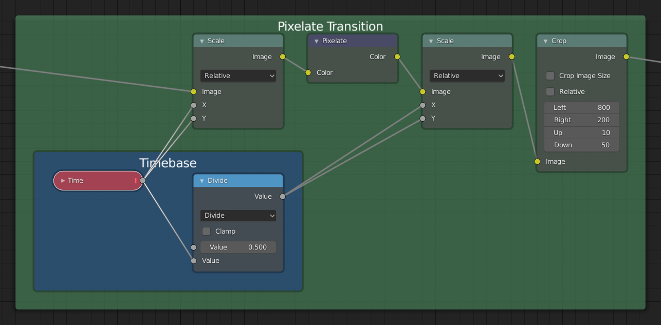

The Frame node is used to organize and group other nodes within the editor. It helps manage complex node trees by visually grouping related nodes together.
Frames are particularly useful when the setup is too large to view easily at once, or when you want to separate logical sections of a node tree without creating a reusable Node Group.
Example of a Frame node.
Example of a Frame node used to organize nodes.
Uso
  • Nodes can be added to a frame by dragging them inside it.
  • Moving the frame also moves all contained nodes.
  • Frames can be resized by dragging the corners or edges.
  • The frame can display a custom label, useful for naming sections of your node setup.
