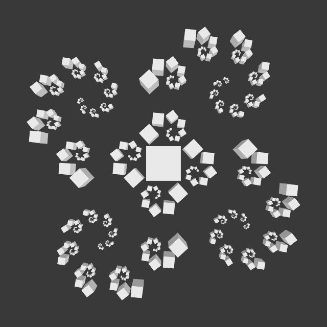

Fractal¶
Multi-level array animated with motion blur.¶ |
Fractal created with multiple arrays. Sample blend-file.¶ |
