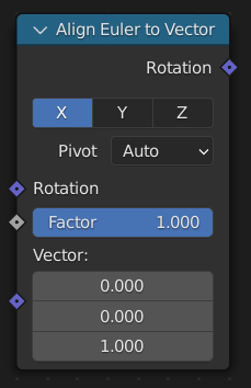

Align Euler to Vector Node
../../../_images/modeling_geometry-nodes_point_align-euler-to-vector_node.png
The Align Euler to Vector node.
The Align Euler to Vector node rotates an Euler rotation into the given direction.
