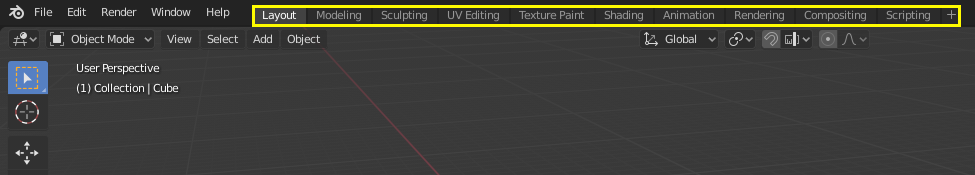

Workspaces are essentially predefined window layouts. Each Workspace consists of a set of Areas containing Editors, and is geared towards a specific task such as modeling, animating, or scripting. You’ll typically switch between multiple Workspaces while working on a project.
../../_images/interface_window-system_workspaces_screen.png
Les espaces de travail se trouvent dans la Barre supérieure (Topbar).
Contrôles
Onglets
Click on the tabs to switch between the workspaces. You can also use the keyboard shortcuts Ctrl-PageUp and Ctrl-PageDown. Double-click a tab to rename the workspace.
Ajouter +
Cliquez sur le bouton Add pour ajouter un nouvel espace de travail.
Menu contextuel RMB
Le menu contextuel contient des options pour dupliquer, supprimer et réorganiser les espaces de travail.

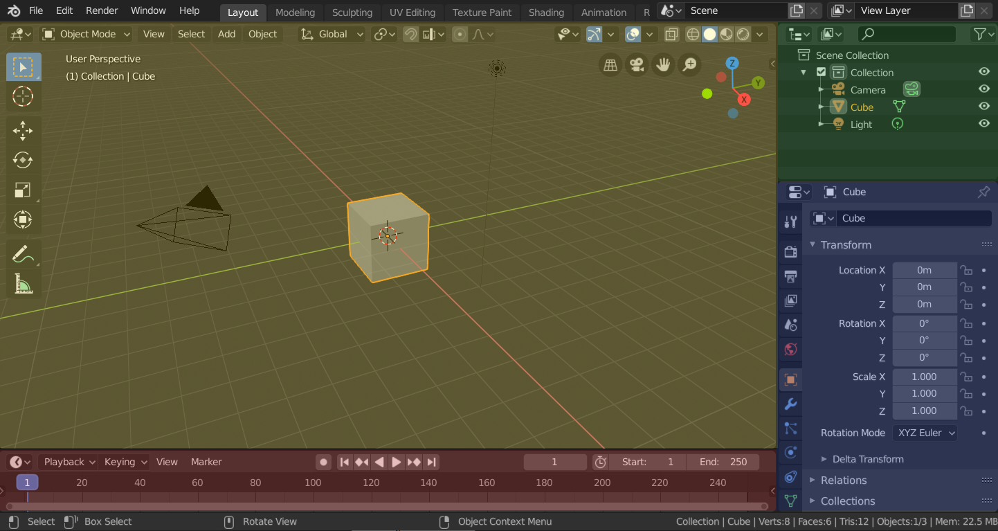

Blender’s default startup shows the « Layout » workspace in the main area. This workspace is a general workspace to preview your scene and contains the following Editors:
../../_images/interface_window-system_workspaces_layout.png
Disposition des espaces de travail dans Blender avec quatre éditeurs.
Vue 3D (jaune), Outliner (vert), Properties (bleu) et Timeline (rouge).
