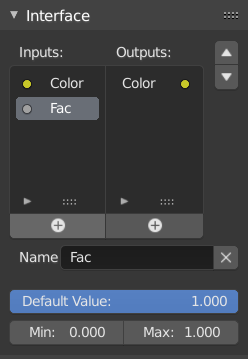

Bảng -- Panel
Tham Chiếu -- Reference
Chế Độ -- Mode
Toàn Bộ các Chế Độ -- All Modes
Bảng -- Panel
Sidebar region ‣ Node ‣ Interface
../../_images/interface_controls_nodes_groups_interface-panel.png
The interface panel for editing groups.
Sockets can be added, re-ordered, or removed, descriptive names can be added and the details of the input data value defined here.
If you have multiple inputs or outputs, they can be re-ordered by selecting the socket in the list and then moving it up or down with the arrow buttons on the right side of the panel. The larger plus sign buttons below the list will add an unconnected socket of the same type as the selected socket or a value socket if there is no selection. The triangle at the bottom of the list has filtering functions to facilitate finding nodes if the group has a large number of sockets.
