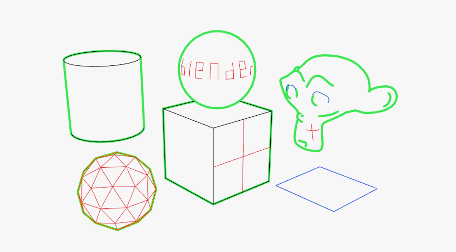

Thể Loại Cạnh -- Edge Types
Hình Bóng -- Silhouette
Nếp Gập -- Crease
Shows only edges whose adjacent faces form an angle sharper than the defined view map's Crease Angle.
Đường Ranh Giới -- Border
Border shows open mesh edges, i.e. edges that belong to only one face. An open cylinder has open edges at the top and bottom, and a plane is open all around. Suzanne's eye socket is an open edge.
