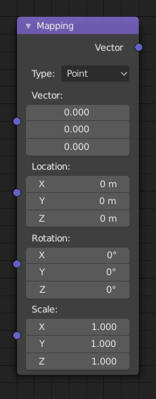

Nút Ánh Xạ/bản đồ/thị (Mapping Node)
The Mapping node transforms the input vector by applying translation, rotation, and scaling.
../../../_images/render_shader-nodes_vector_mapping_node.png
Nút Ánh Xạ/bản đồ/thị.
Đầu Vào (Inputs)
The inputs of the node are dynamic. In particular, the Location input is only available in the Texture and Point vector types.

Tính Chất (Properties)
Kiểu Véctơ (Vector Type)
The node applies the transformation differently depending on the semantic type of the input vector.
