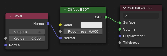

![../../../_images/render_shader-nodes_input_bevel_example_setup.jpg](../../../_images/render_shader-nodes_input_bevel_example_setup.jpg)
A minimal node setup for working with the Bevel node.¶
