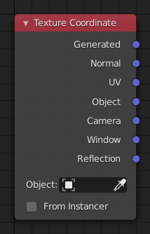

Узел Texture Coordinate.
Узел «Текстурные координаты» широко используется для задания текстурных координат, обычно используемых для входов «Вектор» текстурных узлов.

Object (объект)
Определяет объект, из пространства которого берутся координаты. Влияет только на выход «Объект».
From Instancer Cycles Only
If the object is generated by instancing from vertices or faces, use texture coordinates from instancer. This only affects the Generated and UV outputs.

Сгенерировать
Automatically-generated texture coordinates from the vertex positions of the mesh without deformation, keeping them sticking to the surface under animation. Range from 0.0 to 1.0 over the bounding box of the undeformed mesh. See Texture Spaces for more information.
Normal
Object space normal, for texturing objects with the texture staying fixed on the object as it transformed. The Normal output can be used on Point and Spot lights. The coordinates will take the rotation of the light into account.
UV
UV texture coordinates from the active render UV map. See UV Mapping for more information.
Примечание
In order to select UV map other than the active map you must use the UV Map node.
Object (объект)
Uses an object as a source for coordinates. Often used with an empty, this is an easy way to place a small image at a given point on the object. This object can also be animated, to move a texture around or through a surface.
Камера
Координаты положения в пространстве камеры.
Окно
Location of shading point on the screen, ranging from 0.0 to 1.0 from the left to right side and bottom to top of the render. This is well suited for blending two objects.
Отражение
Uses the direction of the reflection vector as coordinates. This is useful for adding reflection maps. You will need this input when using environment maps.
