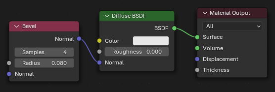

Primeri¶
A minimal node setup for working with the Bevel node.¶
