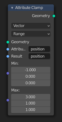

Attribute Clamp
../../../_images/modeling_geometry-nodes_attribute_attribute-clamp_node.png
The Attribute Clamp node.
This node inputs one attribute and clamps the values and writes these to the result attribute.

Atribút
Name of the attribute that is to be clamped.
Výsledok
Name of the attribute where the computed result it stored. If an attribute with this name does not exist yet, a new attribute is added. If it does exist, the values of the attribute are overridden.
Minimum
Minimum value. This socket changes according to data type selected.
Maximum
Maximum value. This socket changes according to data type selected.
Vlastnosti
Typ údajov
This determines the data type of the result attribute. This also changes the Min and Max inputs to match the data type.
Operácia
This determines how the data is clamped.
Minimum Maximum
Constrain value between min and max.
Rozsah
Constrain value between min and max, swapping inputs when min is greater than max.
Výstup
Geometria
Štandardný výstup geometrie.
