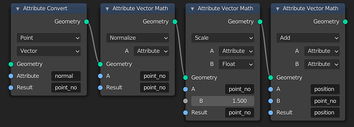

Here are nodes to move points along the normals of a mesh or points from the Point Distribute node. First the normal attribute is moved to the Point domain. Then it is normalized, the length is changed, and it is added to the position. The Factor input could instead be an attribute to vary the displacement per point.
../../../_images/modeling_geometry-nodes_attribute_attribute-vector-math_example.png
