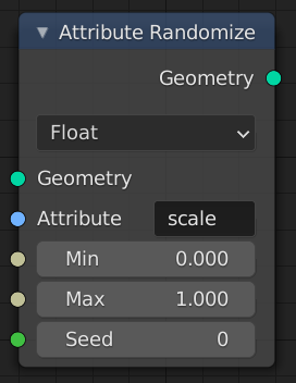

Attribute Randomize
../../../_images/modeling_geometry-nodes_attribute_attribute-randomize_node.png
Attribute Randomize Node.
The Attribute Randomize node replaces the values in an attribute with random values within the given range.
