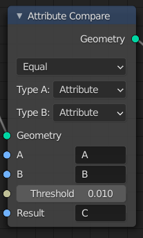

Attribute Compare
../../../_images/modeling_geometry-nodes_attribute_attribute-compare_node.png
The Attribute Compare node.
This node reads two input attributes as floats and allows for basic elementwise comparison operations. Like the Attribute Math node, it is also possible to switch to using single values as inputs. This node can be combined with the Point Separate node for more control over which points to separate to the second output geometry.
