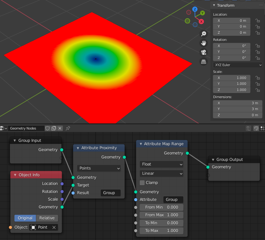

Napríklad
../../../_images/modeling_geometry-nodes_attribute_attribute-map_example.png
Attribute Map node used to adjust a vertex group.
